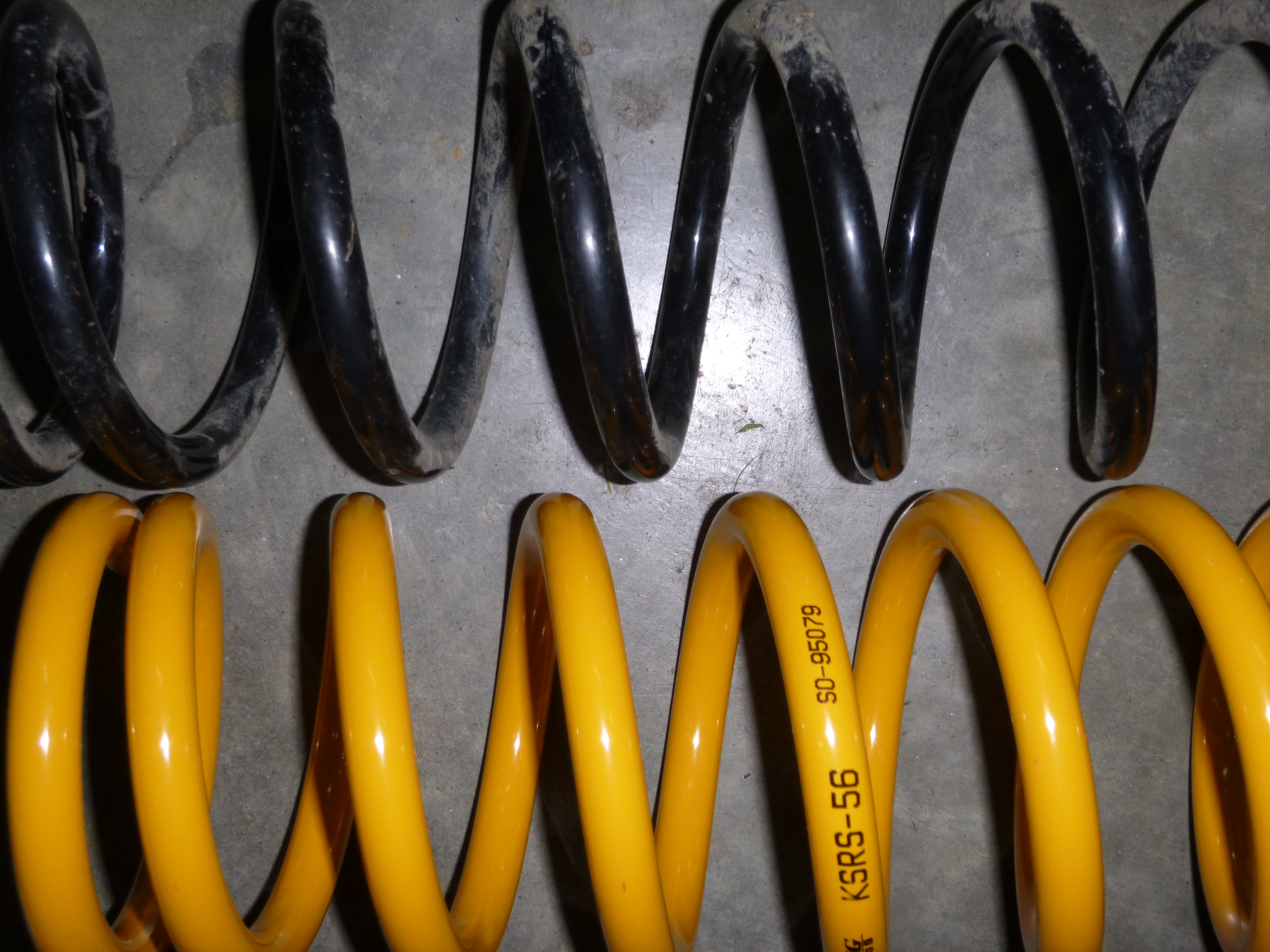

    For those towing or hauling heavy loads, I must highly (HIGHLY) recommend King springs. I picked up a set for ~$500 ("standard" height for 2009+ Forester) and am only sorry that I did not buy them at least a year sooner! They are worth every penny, my friends!
    Check out the difference:
    July 2010 fishing trip:
    July 2014 fishing trip (essentially the same load):
    Spring Comparison:
