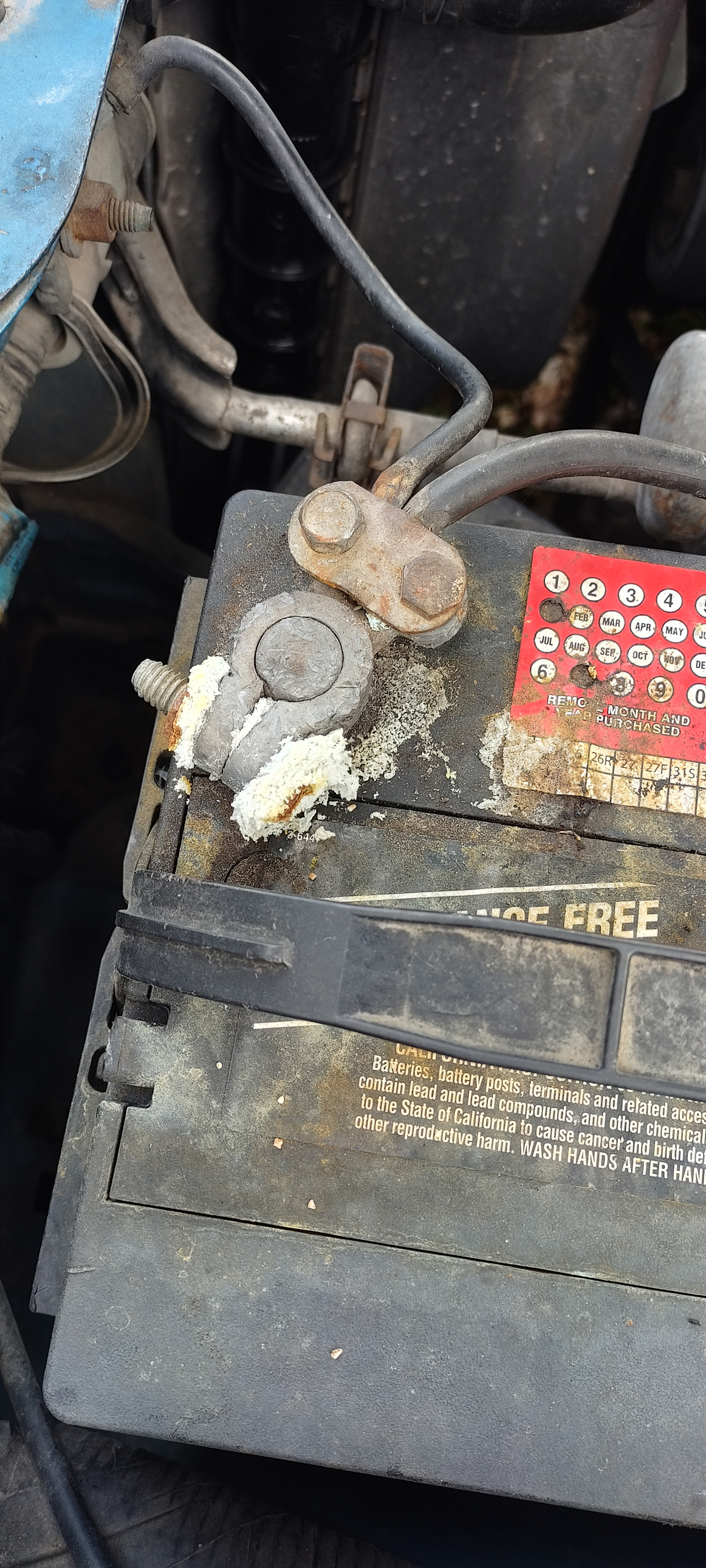

  • MgWmsMgWms Member Posts: 2
    This is the negative side. (The positive is clean.)
  • thecardoc3thecardoc3 Member Posts: 5,840
    The ground problem affecting the lights is in the back of the truck. Either one of the sockets that the bulbs go into or the ground wire for them.
    That being said, what you have at the battery is a problem in itself and you need to plan on replacing that battery cable. A bolt on ends is at best a temporary solution until a new cable is installed.
