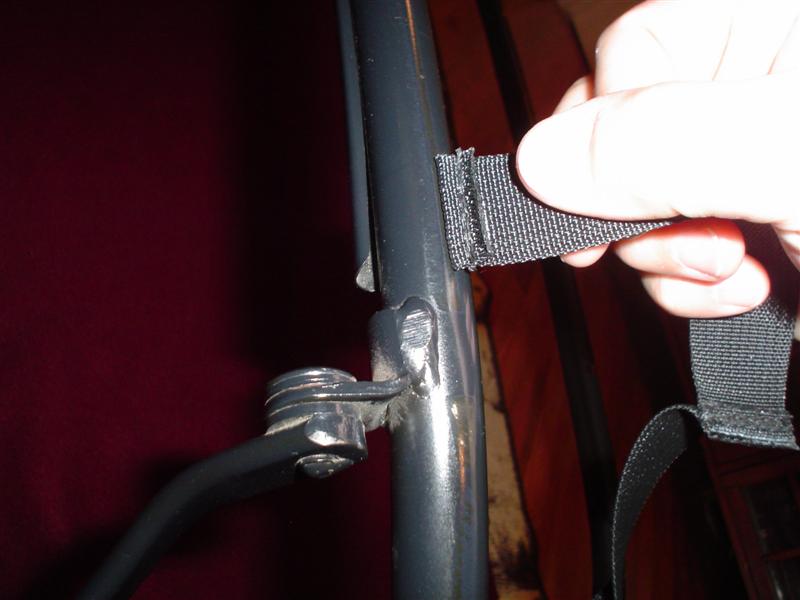

    I wonder if you have the wrong hood and the wrong top as well, perhaps the previous owner didn't know the differences between an NA and an NB Miata.
    I had a 1993 and got a Robbins top with a glass rear window. It had no zipper as well, but it required that I add a couple of nylon straps that bolt diagnocally from one of the top brakes to another, that helped the top slide down. So basically my 1993 top (NA) was converted to a 1999 style top (NB).
    I don't have that car any more, though maybe you could contact Robbins and ask them for instructions for the top that converts from a zipper to a non-zipper style. Unfortunately it was a very complex task. That wasn't the hard part, per se, but you would have to take the top half way off to fix that if it wasn't done.

    Thanks for the reply, Please bare with me on this, I have only had the car a few weeks so i am not well up with.. NA and NB?, or Robbins, I guess its the difference in our countries, I am in the UK, You call it a Miata, here its a Eunos roadster, ok..same thing really a Mazda mx5 lol, but I'm lost with NA and NB, I only assume Robbins is the soft top makers?.

    as regards the straps, hmm, i must take a look again tomorrow, i am pretty sure i saw one each side the hood.
    Thanks again!
    The straps I'm referring to went from one of the top frame/braces to another, diagonally. I think you can see at least a part of them even when the top was up. They would basically pull one of the braces out of the way to let the top fold and make room for the big glass.
    Originally the NA models had plastic windows that you would have to fold in the middle or unzip to get down.
    So the straps are necessary for the later NB-style tops.
  • lordelpuzlordelpuz Member Posts: 16
    Absolutely brilliant, Ive been searching for a site and info like that for weeks.
    Thanks again, I have solved the problem now and the top comes down nicely.
