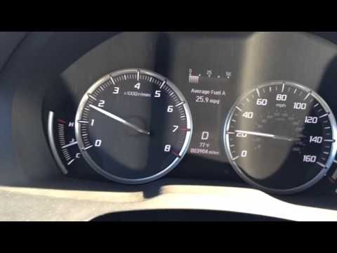

    I just took my 2014 MDX to the dealer. The tech said he will try another 2014 MDX to duplicate the issue and consult with Acura. I took a video since I knew it was hard to duplicate: http://youtu.be/JvyQjw-5gO4

    Bought mine in November and it goes through spells of doing this same thing - mostly when the car is warm, weather is warm and when I'm traveling at a level speed (20-70 mph) with my foot consistent on the gas. I'm so glad someone caught it in video! Haven't been in for my first service yet, but will inquire about the recall when I do. Hopefully others will keep this page updated with their outcomes.

    Bought my 2014 MDX about 3 months ago..experiencing the EXACT vibrations that is in the video above. Have a an appointment with the dealership in a few days. Curious as to what they will tell me

    I have the same problem from the video. I bought mine 10/2013. I just finished driving the car with the mechanic. He didn't seem to think it was a serious issue. This is very concerning as the vibrations are quite scary to drive with. This is my second Acura MDX. The first one was a beauty. I wouldn't buy anything Acura again.
    Can any of you who has had this problem before please comment on how it was resolved?
