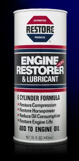

    When you check the oil every time you fill up, did you check BEFORE drain the oil? or AFTER fill up the new oil? How does it look like? and did you check the dirty oil that you drain out of the oil tank? I mean, did you notice the "volume" of the dirty oil actually shrink? and how much loss? for that 15,000 miles. Yours may not have loosed too much because you said you never got low oil light on, but it may be useful to know how much quart loosed.
    Mine Nissan Quest 94 had engine oil leak since dozen years ago, and the dealer I checked wanted over $1,000 from me to repair. Basically, their reason is that it was a gasket needed to be replaced, but it cost huge of labor to reach that gasket and reassemble, and they wanted me to leave the van with them for a few days. I never have them did anything because in my mind, if the auto mechanics can NOT get the job done in an hour or two, they did NOT know how to do it correctly, may be they did not have experience on the problem, or they simply do it brute force. But, it is hard to reason that dealer has no experience nor need to do it in hard way; the only thing I can think is that they want to charge you more by asking you to leave the van there to make you feel they spend more time on doing your car, which they don't.
    Anyway, thereafter, every few months my "low oil" light would come on, depending on how much I drive; it did not seem to leak oil when it is parked still, but it may leak during driving and pull into parking. And, I always had a quart of engine oil in my van, as soon as the light came on, I just add one quart, and the light went off right away. Then I kind of lose the hassle of changing oil because every 15,000 miles when I checked my engine oil, the dipstick always shown very clean. And, of course, I also lost the hassle to change engine oil filter.
    Many years later, I noticed it took longer and longer for the "low oil light" to come on, and eventually it kind of not come on any more naturally. When I mentioned this to a local auto repair owner one day, he said, of course, as the engine oil got thicker and thicker, eventually, it would seal the leaking gasket by itself. So, then instead of adding a quart of engine oil whenever "low oil light" on, now I need the oil change again, and that's why last time I changed in 2008.
    Since I have been so used to not bother with oil change, and I kind of forgot needed to, but it seemed fine, except, every so often, like 3,000 to 5,000 miles, I just top off 5w30 till recently I found this Engine Restorer while search for solution to fix the "water in tank problem", and add the whole can to top off the engine oil and got all the wonderful effects as mentioned in testimonials. I thought at the time the problem may have caused by not changing oil since 2008, but it turned out is not, but I am very happy to the positive effects gained.
    Engine Restorer advises to add every time do oil change; however, I was in the situation either to see auto mechanics or solve the problem myself, so I did not do oil change, instead, I just added a can into my crankcase to top off the engine oil which looks dirty at the time.
    Then, the magic happens immediately. The first try to drive, I felt the engine gets calmer, and through out the way, every day the engine quiet more. Until one day, my wife asked me why our Nissan Quest 94 engine was so quiet, what did I do? And, also another day when my son trying to start the engine when it was ALREADY started; he could not hear the engine sound. Now we have to rely on the RPM meter to tell if engine started or not. While driving on the road, if we open the winter, we, in fact, hear other cars' engine noise, but not ours. How amazing!
    Before using it, every time I pull the van into driveway, my wife noticed the bad smell when engine stopped, but after using Engine Restorer, the bad smell gone. It was not the smell of engine oil, I think it was the bad smell of exhaust. Then, I notice when I started the engine in the morning, I got NOTHING smoke came out from the exhaust pipe but some water about an oz or two.
    From then on, I tried to locate Engine Restorer wherever I went and took down the price. I have found so far the best prices of that same Engine Restorer of 3 sizes, 4 cylinder, 6 or 8, Walmart seemed to be the cheapest. And, that's great! because we travel a lot, about 150 nights in the hotel each year, so any time we had a need to use Engine Restorer to top off engine oil, we know where to find at best price.

    You can't tell anything by oil just by looking at it. It's supposed to hold stuff in suspension so it's not unusual for it to turn dark right after you change it.
    No, don't bother looking at the dipstick when I change my oil.
    And again, I don't believe in putting additives in my van. Testimonials don't really mean squat to me - if you truly want to know the condition of your oil (and thus your engine), pay the ~$20 for an oil analysis.
    With all the restorer links in your post, you sound like you're shilling for the company. Are you getting kickbacks from Heet too? Lot of good your restorer did if you have leaks. ;)

  • nissanquest94nissanquest94 Member Posts: 81
    Yes, every time after I changed engine oil even not replace oil filter, I could feel engine running smoother even before I tried Engine Restorer.
    This time Valvoline did not leave room for me to add Engine Restorer image as months ago I added it to my crankcase after 3 year not change engine oil and filter. Maybe I have got used to the smoother and much quieter engine that Engine Restorer brought me.
    Now I have to wait till engine oil shrink in the crankcase to add some Engine Restorer, may be I will just buy small bottle for 4 cylinder rather than 6 I added last time. It took about 3 to 6 months to shrink 1/4 quart when others may change oil and oil filter, I often just top off with 5w30 recommended by Nissan Quest 94 manual.
    I did have other problems because the "check engine light" on, and I just adjust idle screw after start engine and idling to tune it to most smooth position. Now, it can idle well, especially when stopped at traffic light.
    When I started the engine first time of the day, the engine will stall unless I push the gas pedal, and about two minutes later, it will idle normal, and through out the day.
    Someone I met on the parking lot asked me when was last time I replace "fuel filter", and I said I never replace "fuel filter", should I? He said fuel may be clogged by dirty fuel filter. Is that right? May be I should change a new fuel filter ... How much would it cost?
  • jaggiebunnettjaggiebunnett Member Posts: 10
    some engine restorer additives are like molasses so beware, your engine may likely full of sludge!

    Which engine restorer additives would you suggest to avoid? Or, even better, which ones that you have used for your Nissan Quest and work great?
    So far, I only used Engine Restorer once, and it seemed to give me immediately great effects of the following:
    1. As soon as I start the engine, I notice the engine quiet down, and it quiet more each day for the following few days I drove till very very quiet.
    2. I noticed the smell used to came out of under hood when engine start were all gone, instead, it smelled very good, like the smell of early morning in the forest.
    3. No more smoke came out of the tail pipe, in fact, it came out some water drips when it starts and warm up.
    4. The engine oil turned from dark brown into very clear like new engine oil.
    5. The millage increased unexpected.
    Basically, what they testified in their website in line with my own experience with Engine Restorer. And, every time I revisit their FAQ section, I understand it better with more insights.
    For example, I have set up a schedule to wait till my newly changed engine oil to shrink 1/2 quart to add Engine Restorer of 4 cylinder (rather than 6 cylinder) instead of use Engine Restorer every time I changed engine oil and filter (because I only would change engine oil and oil filter every 3 years, other time, I would just top off the 5w30 engine oil as recommended by Nissan Quest manual), and as I top off Engine Restorer rather than 5w30 from now on, I would have more of it than just bigger can for 6 cylinder. This also came from my own experience on adding Engine Restorer 3 year after previous engine oil and filter changed. I feel it does not need to be replace Engine Restorer every time change oil and oil filter.
    If from most auto mechanics "myth" of "3,000 miles or 3 month" change oil and oil filter and Engine Restores' suggestion of add it every time change engine oil. It would be too much waste. However, if add it every 3 year when I changed oil and oil filter, it may be too long (yet to be seen, and I will find out). The thing is that I do not change oil and oil filter myself, instead, I drove thru to get them changed and replaced by places like Lube Express or Valvoline Express, so it is hard for me to bring a can of Engine Restorer to ask them to add for me.
    So the perfect timing to add Engine Restorer may be wait 3 to 6 months when engine oil shrink dark brown to about 1/2 quart to top off with 4 cylinder Engine Restorer. One thing that bothers me is that their design is like coke, you either open and use the whole can or not open or waste. Ideally, if it can be squeeze into crankcase a few oz every so often or whenever needed like Lucas fuel injector cleaner that I squeeze into gas tank every time I going to go long trip.
    Another thing I need to find out is to see if there is gallon container of Engine Restorer. e.g. the 5.25oz Lucas fuel injector cost about $5 at Walmart, where as 32oz, about 6 times more, only cost $10, and I found 128oz the gallon size (4 times more) of Lucas fuel injector at Pep Boy only $29, so I use the gallon size now. Every time I bought the gallon, I filled the two 32oz bottles, and every so often when I go long trip, I just squeeze a few oz into fuel tank depending on how much gas left, NOT need to worry about fill the tank right after.
