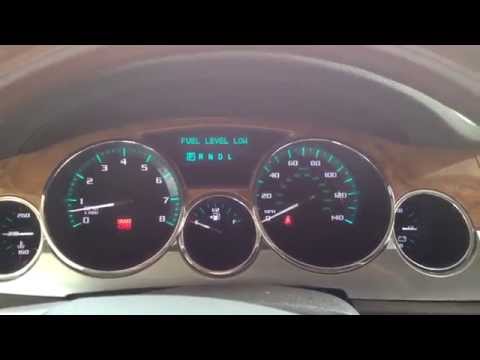

    I had the same issue, 2008 Buick Enclave cxl. It was the purge valve. It gets corrupted by overfilling the gas tank too much ( really). There are two of them, one in the engine compartment and the other near the gas tank.
    https://www.youtube.com/watch?v=rTvzHXrmjac
