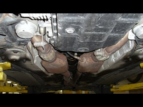

    And this Youtube video too.
    https://www.youtube.com/watch?v=HFv-ugzzr8M
