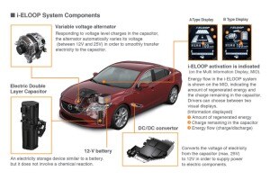

image2014 Mazda 6 With Fuel-Saving i-Eloop Technology Priced
The 2014 Mazda 6 midsize sedan with optional i-Eloop technology that helps to conserve fuel starts at $32,570.

    Hard to believe that taking the load of the alternator off the engine (via Iloop) yields such a huge jump in fuel economy. And on the highly, there isn't much deceleration to re-charge the capacitor. Can anyone explain.
  • se_riouslyse_riously Member Posts: 94
    techman41973 - Based on the explanation here:
    http://www.mazda.com/mazdaspirit/env/i-eloop/
    It appears the alternator can be de-coupled from the engine to minimize drive losses - hence the improvement in city and highway mileage. Also, the alternator can charge the capacitor whenever the gas pedal is released (coasting), not just only when braking.
