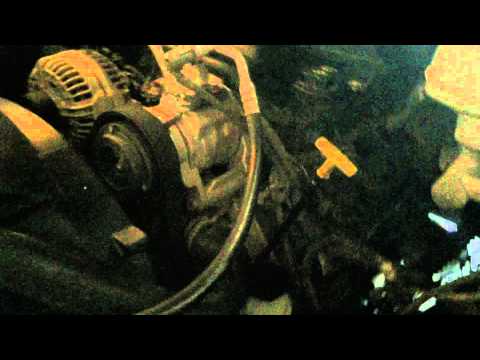

ok so recently i have noticed this ticking sound. i have read a lot online about how some of these trucks have the "hemi tick" its not an exhaust manifold leak due to broken bolt because i had those replaced maybe 3-4 weeks ago.. i use a premium conventional oil and a gold star Napa filter.
it only ticks on a cold start once its at operating temp it sounds fine.
truck has about 110k miles on it
videos....
cold start in the morning. after sitting all night.
https://www.youtube.com/watch?v=xuCImIGg13w
sound from underneath the truck where i can here it most
https://www.youtube.com/watch?v=5OqLdGRdTFM
after once around the block driving low speed and slow starts.
https://www.youtube.com/watch?v=hAAJJV9Fiw0

    Sounds like an exhaust leak between the manifold and the pipe. As manifold and pipe heat up, the metal expands and the leak disappears.
