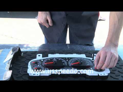

  • 93tracker5spd93tracker5spd Member Posts: 194
    Hello! Me again. Was unable to find an instructional specificity tailored to your need. But, I did find one about installing a new gauge face from US Speedo, it has all the specifics about how to pull the cluster and re-install it. And it is done by a professional installer. Hope it helps.
    https://www.youtube.com/watch?v=ic1uIRu8ToY
  • rockymntnhighrockymntnhigh Member Posts: 3
    Thanks to all. I've pulled the cluster out and have it ready to ship to a company that will refurbish it.
