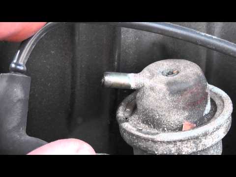

    Check the fuel pressure regulator. There are videos on youtube showing how to pull off the vacuum line. If you get raw fuel coming out of the end of the line or a heavy gas smell, run the car with the line off. You can plug the line with a golf tee or pencil. After a few minutes of idling see if you get fuel coming out of regular because of a cracked diaphragm inside. That would put a lot of extra fuel into the intake manifold that the engine can't compensate for with extra air.
    If your engine runs better with vacuum hose off and plugged, that would be a good clue.
    https://www.youtube.com/watch?v=AKtR_yF7bi8
    FPR can be replaced with parts from aftermarket stores or rockauto.com.
