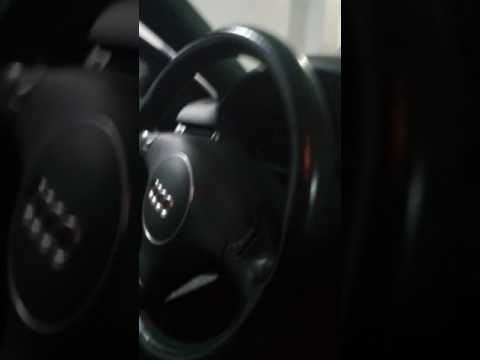

9) Put the key in the ignition, and now I have the problem that you can see in the video: many warning lights turn on on the dashboard and there's a strange noise coming from the engine bay. If I turn the key to try to start the car, I get that awful noise and you can see all lights kind of flashing.
Here's the link to the video: https://www.youtube.com/watch?v=mgAIy0v1NT8
I hope you can help me!

    00588 is the drivers front airbag circuit (column) not the side airbag. The video suggests low system power. What is the battery voltage at before you turn the key and then after turning it to the run position?
    Can your VAG COM perform a full module scan or does it get locked up?
    If it can, what codes are setting in which modules?
    If it locks up on the full system scan, can it communicate with any modules individually?
    Does it report any modules that should be present as missing?
