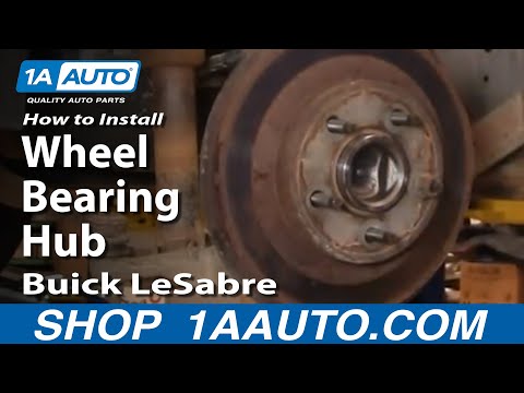

    https://www.youtube.com/watch?v=fiqt7jmcBd4
    In the video he just keeps hitting on one side then the other with a 3-pound hammer. You might try soaking the area where the hub meets the spindle with PB Blaster hoping it softens the corrosion there that's holding the hub.
    Repeated vibration is your friend.
