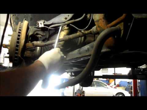

    Ok so I found this under my blazer in the front? I didn’t notice it there previously but then again I never really looked? That may have been stupid of me but I saw it hanging down on my way back to my truck after stopping at the store. Know what it is? I’ve got zero knowledge with cars so 😬😬.

    Not exactly sure (asking some folks) what that is, but I did some playing with the photo to get a better look at those "horns". I suspect those might be protection for the undercarriage (could be wrong as I'm guessing). They certainly look like big chunks of steel protecting the axles from things like rocks someone might encounter offroad.
    In any event, they don't look connected to anything that's involved in making your Blazer move, and the noise you describe and have recorded in the video sure sounds like something in the drivetrain.
    That's a sway bar. I can see the eye holes at end end.
    The eye holes _used_ to have "links" connecting the sway bar to the moving part of your "A-arms" on the front suspension. The links typically have rubber bushings on each end to soften vibrations and a rod through the middle. The rod corrodes away with salt and beet juice used to treat the roads for winter here in the Ohio area.
    Usually one side breaks and gives a rattle noise that folks notice when turning in and out of driveways at lower speeds. But on yours it looks like both broke.
    Here's a video that will show replacing them. Can be a do-it-yourself job if you have proper jacks to lift both sides at the same time to avoid any sideways uneven heights--that causes the sway bar not to be in a neutral position.
    Good luck with the replacement.
    I have not previewed the video. Sometimes they're not useful. I thought the initial picture shows the same type of hefty sway bar that you have hanging down, so I hope it's good to go!
    https://www.youtube.com/watch?v=jD0B_mX_vXY
