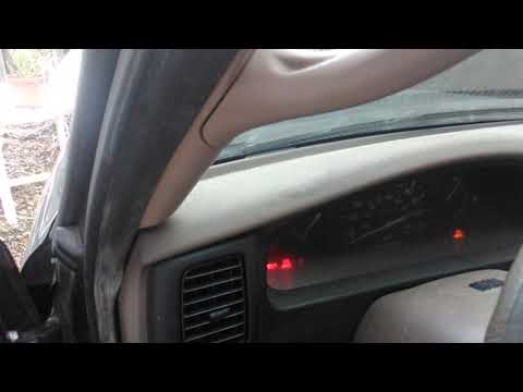

2.4L 5sp, 74k miles(not a typo, yes 74 thousand miles) My SRS lights been on solid (no blink) for 2 years. I finally decided to look into it. Below is a video of the codes with Tc and CG bridged(shorted). After ignition on for over 20 seconds.
Yes I 1st checked all the fuses, with ohm meter.
This video is started before Tc and CG are bridged, so u see it lite solid. Then as Tc and CG are bridged, it goes out for 4 seconds, then starts showing the codes. It cycles 3 times through the codes. Here:
https://youtu.be/5lM5NeeDCuY
another video taken the day before. This video started mid way through the codes:
https://youtu.be/gaiUZKllk5c
It looks to me like 31, 11, 1, 2, 52 or maybe 31, 111, 2, 52. Since 1, 2 and 111 dont exist, maybe it is 11 and 12.
