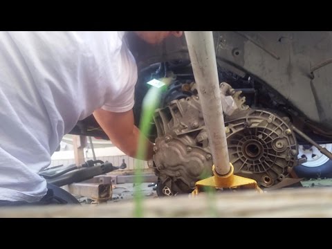

    I have been starting to think here if the hole in the second picture where it looks like a gear is exposed is supposed to be that way or not. I saw somebody on youtube where he was replacing the transmission showed a brief moment of the exact area I see and it seems like that is an intentional design by the manufacture at 41:58
    https://youtu.be/Ydrc6i91T10?si=GK3IQpJCcFhPNlr5&t=2518.
    I wonder... Why is it exposed?
