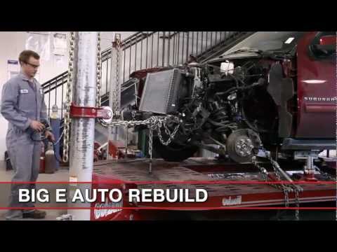

    Body shops put the chassis on a "frame machine" which allows them to push and pull sections of the car that have been damaged back into their original positions with accuracy in the .X millimeter range. This first link is a company that manufacture and sells these machines.
    https://prolinesystems.net/frame-machines.html
    The next link is a demonstration of using this kind of equipment. There are many like it on YouTube. If you search "Frame Machine" there you will also find more portable versions and even some home made devices. Maybe one of them will work for you or maybe even give you the answer you seek as far as overcoming the damage you are trying to repair.
    https://www.youtube.com/watch?v=ddUjxMj6RCU
