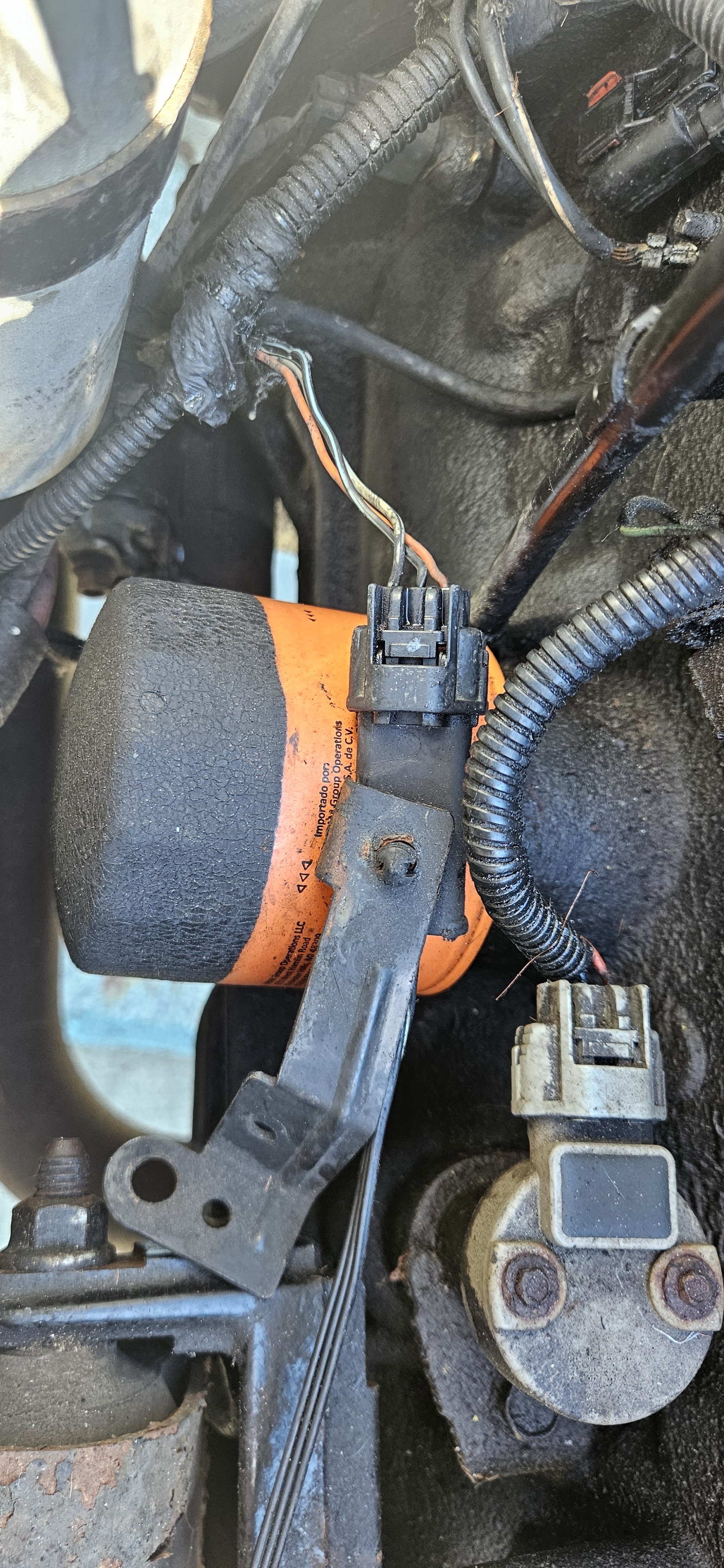

Need help identifying what this goes to
s_simais_simai Member Posts: 1
edited November 2025 in Jeep

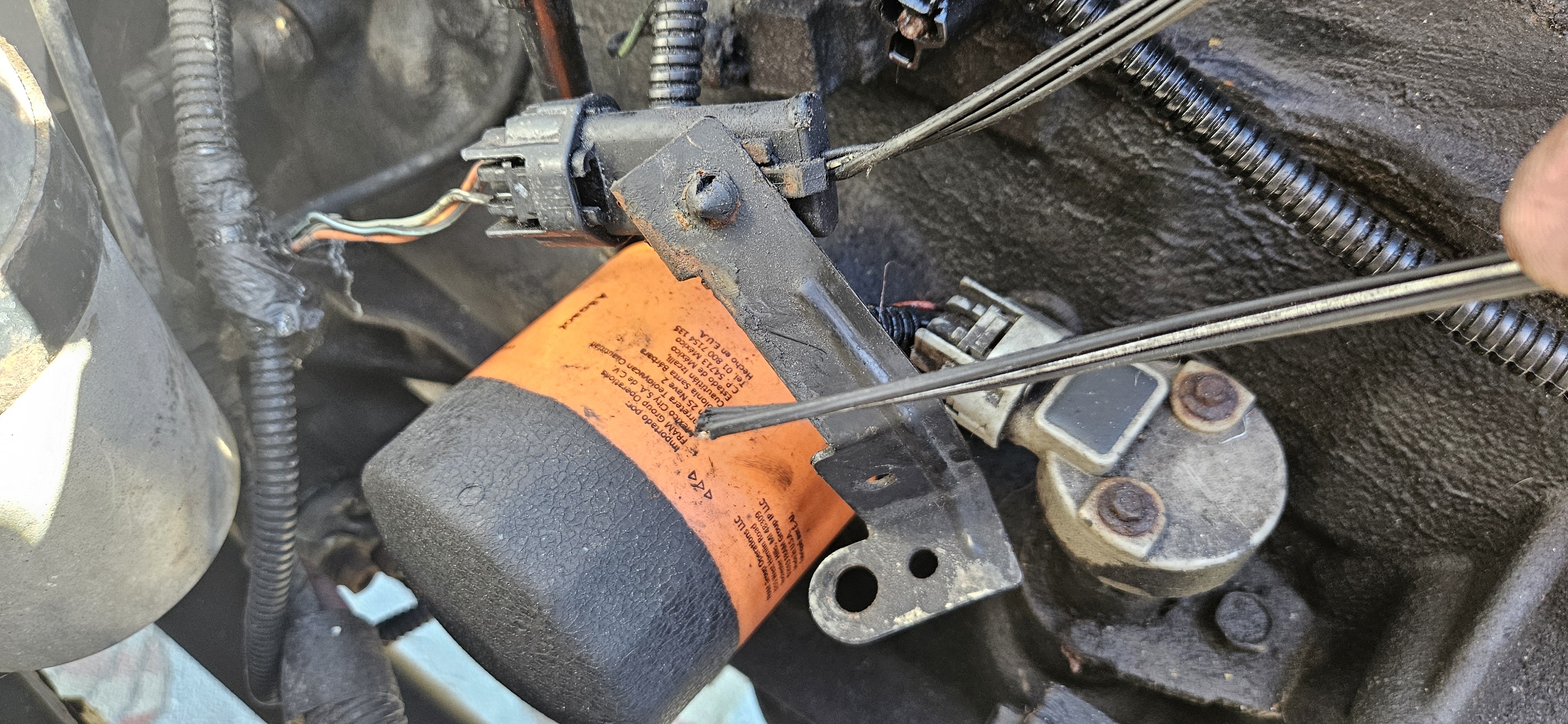

Can anyone tell me what this goes to? My Jeep didn't start and believing it was a coil pack issue, I took it out and found this connector and the wiring off the connector was chewed or broken. I added photos but its a red,white, black with blue stripe wire coming from the harness off the firewall that goes into a connector that becomes 2 black and a black striped molded wire, the connector has a bracket.
  • thecardoc3thecardoc3 Member Posts: 5,869
    That looks like it is the crankshaft position sensor connector. The colors are Orange, Black Lt Blue, and Gray/Black.
