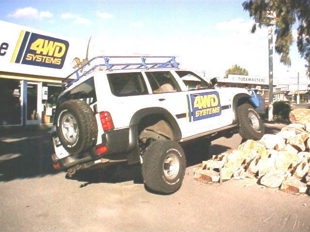

offroader
-mike
A Nissan Patrol (98 model) with a 6" lift from 4WD Systems.
