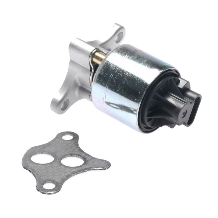

  • imidazol97imidazol97 Member Posts: 27,717
    Does it sputter if you shift into neutral while slowing down? Does it stall?
    EGR valve is one possibility. It can be removed and cleaned with carb cleaner. Check the tube for deposits under the EGR.
    Pull off the vacuum tube on the Fuel Pressure Regulator on the front of the motor. If there's liquid gasoline in the tube or you get a strong smell of gasoline, it may be leaking gasoline from the fuel line into the intake system.
    The FPR is the light aluminum colored thing on the fuel rail in right in the middle of picture going across and about 2/3 of the way to the right.
    EGR valve picture. On exhaust pipe on back of engine close to throttle body end. Has tube going to air intake.
