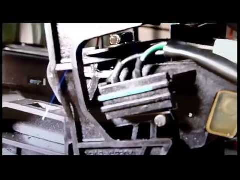

  • CahillsrCahillsr Member Posts: 1
    Forget everything you have been told. There is a small micro switch on the driver's side of the shifter. This switch releases key and unlocks doors when tranmission is put in park. Replace this micro switch problem solved watch this video but don't try to repair just replace switch
    https://youtu.be/A3F8I9xv3nM
    Ebay listing for micro switch
    https://www.ebay.com/itm/302741497377
