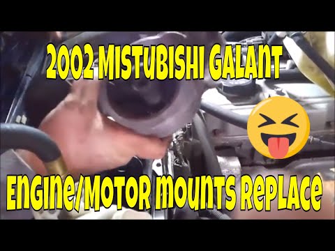

    I have a 2002 galant 2.4L and I needed to change 2 motor mounts due to the rear mount being pretty much destroyed and the passenger has a lot of play the rear one came out and got replaced just fine aside from a few stripped bolts but the passenger side mount won't come out I jacked the engine up just enough to take the weight off of the bolt that goes through the middle and removed the 2 nuts and the other bolt that bolts from the top and this thing has absolutely no movement like I push on it completely unbolted and the engine moves with it with no play  what am I missing?
    This VIDEO might help you. It shows all the mounts being replaced so you have to watch the whole video:
    https://www.youtube.com/watch?v=4EJTgvAcsVI
  • GeorgedobbsGeorgedobbs Member Posts: 2
    Yeah it helped kind of I definitely did everything correctly it should just slide off but is absolutely stuck with zero play when completely un bolted
