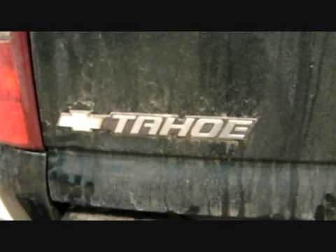

    I have a 2002 Suburban with this same problem. Both single and double seats do not slide forward because the latch underneath are broken. The cables cannot attach because the ends where they fit into are broken as well. Plastic pieces are broken. Not sure where it all fits. It really would help to find a manual or schematic to show how this all fits. Judging from feedback and input I see elsewhere, it's a manufacturer design issue. Not design to last. The video shows the problem (https://www.youtube.com/watch?v=cwxUyuWqDFw) but does not offer a solution.
    Looks like you can just flip the lever at the point where the cable became detached. Not a fix, but it gets you into the rear of the car. If it were me, I'd have a bicycle or motorcycle shop make me some new cables with better 'ends", made of metal, not plastic. I can't quite see how they attach however, so my solution may not be so straightforward.
