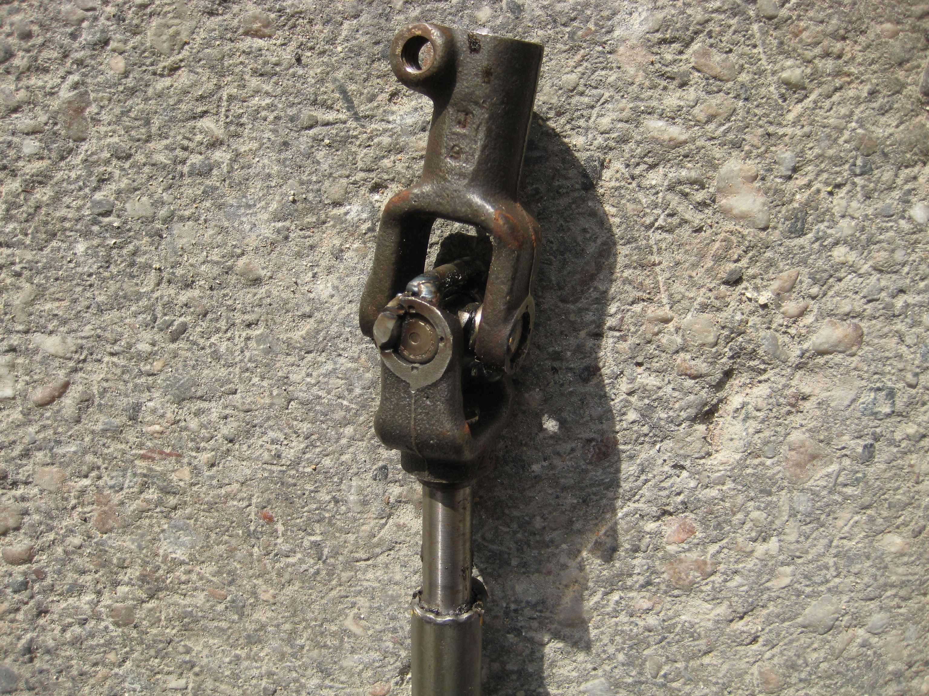

  • judy63judy63 Member Posts: 1
    I got an estimate today for $450 to replace the defective intermediate shaft in my Buick. I am upset because there is no recall for this part and it's defective in, not only Buicks, but the following GM models:
    2001-2004 Buick Regal, 2005-2008 Buick LaCrosse, 2000-2008 Chevrolet Impala, 2000-2007 Chevrolet Monte Carlo, 1998-2002 Oldsmobile Intrigue, and 2004-Pontiac Grand Prix.
    It seems to me that GM had a known defect in the intermediate shaft for a number of years, 1998 through 2008 did nothing about it. Ten years is just too long to ignore a problem. Now I have to pay, as well as many others, for their known defect. I've always enjoyed my Buicks but next time I buy a car it will not be a GM product. I'm tired of their flagrant disregard for their customers. If other car companies can engineer their products correctly why can't GM? Why do I have to pay for a part that's been defective all this time, and why isn't there a recall on the part?

  • Buick_guyBuick_guy Member Posts: 8
    To judy63: you are getting screwed by GM as many others are because this part was covered under warranty a few years ago. Mine was replaced twice and it never cost me a cent. Either your dealer does not want to fight for you or has been told by GM not to cover this under warranty any longer. The reason GM has not done anything - not everyone complains about such things so it costs them less, than to upgrade the new vehicles with the improvement.

  • johnny112johnny112 Member Posts: 2
    On the intermediate shaft clunk. Mechanic and I found the lower u-joint was loose. I purchased a new shaft, which developed the same problem in a short time. Took the old shaft, examined further and found the yokes were spread apart and the joint cups also moved out in the yoke away from the cross. Put in vise, tack welded the cups to yokes and welded rods to yokes to keep from spreading. Probably not the best solution, but has worked. Was tight with a little binding at first, but is now tight and smooth. Believe universal and yoke are too small for application.
    Update. Repaired shaft is still working well. 12-15-2023
