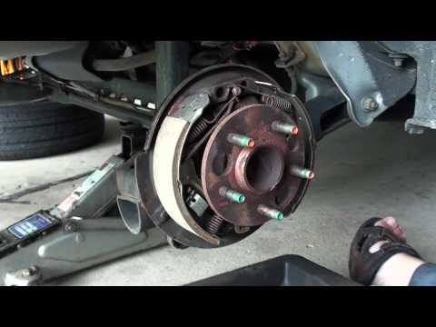

    Here is a great video tutorial on how to replace drum brakes!
    www.ericthecarguy.com
    Replacing Drum Brake Shoes Part 1
    http://www.youtube.com/watch?v=FOvSH-mLhRE
    Replacing Drum Brake Shoes Part 2
    http://www.youtube.com/watch?v=DMUq6bJ1Py8&feature=fvw
    Enjoy.
