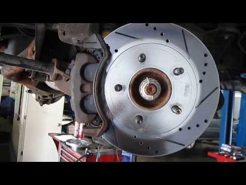

    I had this problem in my 2000 Infiniti I30. It got so bad I bought a used on-car brake lathe to allow me to resurface the rotors every 6 to 9 months, rather than pay $300 each time I had to have it done. I tried cryogenic rotors for $300 but they didn't last any longer than a $60 set.
    It turned out to be caused by something called rotor runout. Runout is the side to side wobble of brake rotor as it spins. When new, perfectly machined rotors were installed in my I30 one of the rotors had 3 times the maximum allowed runout. This was apparently due to a manufacturing defect on the axle itself. I took this car back to the dealer for the judder problem many times when it was under warranty, but they never checked the rotor runout.
    Here's a Youtube video with details on how to check the runout:
    https://www.youtube.com/watch?v=6SbWB2CNqio
    The side to side wobble of a disc causes brake judder to develop very quickly. Machining the rotors helps, but due to the uneven thickness of a machined rotor on a problem axle, even a machined rotor warps quickly.
    The solution for me was to install a inexpensive brake rotor shim to correct the runout. I ordered one from an online auto parts store, installed it along with cheap rotors and have now gone nearly 30,000 miles without machining the rotors. It is just now starting to develop a judder problem.
    Perhaps you have a similar issue on your Honda.
