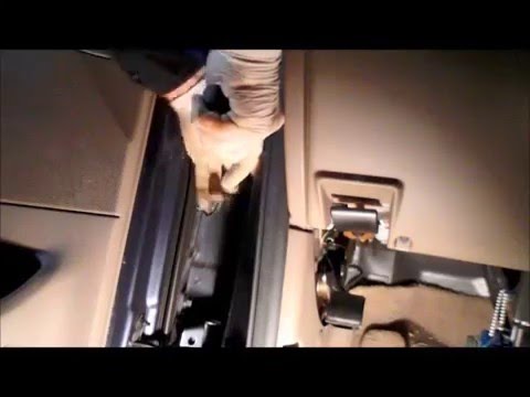

    Hello! Welcome to Edmunds. It would seem that upon investigation, the problem you are experiencing is a common one for these vehicles. And most of the time it is an easy fix. It is caused by one of two items, either the door alarm switch itself which is rare, or the more common cause is the wire that goes to it, this wire goes through a boot at the door to vehicle attachment point, and flexes each time the door is opened and closed. I have posted below a youtube video of the fix done by a professional who has repaired this condition many times and is showing you exactly how to do it quickly and easily. This pro uses a metal tool to dislodge the boot, I would use a hard plastic trim tool. He is a pro and does this all the time, I would surly slip and scratch something with that metal tool. But he is very good and easy to follow! The other conditions are related to that door alarm and should go away with the repair. If there are no other symptoms, it is not likely that the ECU is at fault, it is simply acting upon the erroneous signal sent to it. Good luck, and let us know how you make out. If upon checking, you find no broken wire, the next step is the switch itself which is located in the lock mechanism.
    https://www.youtube.com/watch?v=Vh2r7HrCMRs

    Two comments. The video does a good job of explaining one of the plausible faults for the above reported issue. (The switch itself in the latch is a very common failure) But first, do NOT attempt to do this in place. Remove the kick panel inside the car and the door trim panel so that the entire harness can be accessed by disconnecting the body connector and pulled out of the door. (You can leave most of the internal door connectors attached) The reason to do it this way is that if one wire has broken then all of them are ready to fail so be prepared to add a section of new wire to each wire in the harness. Its much easier to do this once correctly than to have to revisit this over and over again.
