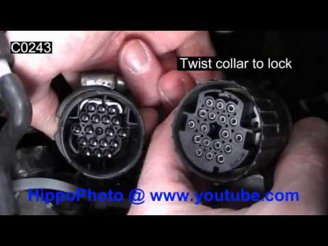

    I live in country Georgia where we don't have professional scanners. https://www.youtube.com/watch?v=VTmdkDuKZ6A I've checked with this video and everything was fine.
