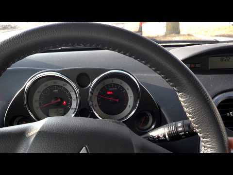

    Might need to be a little more descriptive on the sound. Is it like a rapid, loud clicking? Could be the starter since it's only happening at startup.
    Some YouTube vids with various noises
    https://www.youtube.com/watch?v=KFdA0nLasKs
    https://www.youtube.com/watch?v=rY0ENaUA_Uc
    One of them sound familiar?

    Yes, the first short video is closest to what i'm experiencing, though i noticed this happens on warm weather especially.
