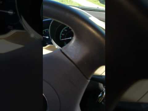

I have a 2011 Chevy Malibu LS 2.4L. When i turn the steering wheel right I hear alot of popping sounds. It seems like the sound is coming from the other side of the steering wheel. I can also feel the little pops in the wheel when I'm accelerating from a stop. Any help is greatly appreciated.
Here's a video if that helps
https://youtu.be/tCPrUC5suac
    This sounds like the chronic Malibu steering disease...so many reports about this....IF this is the typical Malibu issue then it is apparently related to the splines within the steering shaft's u-joint. Various fixes have been tried, including greasing the joint, but apparently replacing it seems to work the best (for a while anyway). Always good to check if this is the problem and not something more serious. This particular noise is apparently not a safety issue.

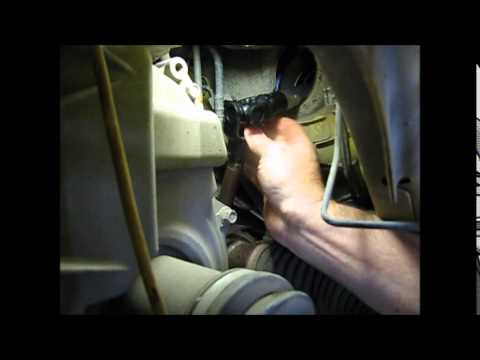

    There are a couple wear problems that happen to the intermediate shaft on those. You can look for signs of dry bearings like in this video on a G6
    https://www.youtube.com/watch?v=6T2oXeNvdQI
