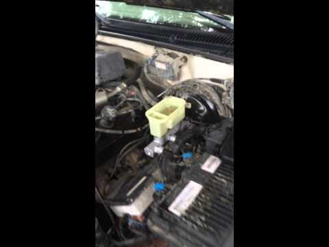

Last time I had small accident... I broke up axle rear... so I changed this, and I changed wheel cylinder, springs, brakes shoe etc. (all rear brakes set)... and I bleeding brakes (rear cylinder wheel) and everythink was great... but when we closed rear vent then... was running blowing air in master cylinder (from FRONT brakes, wtf??) like on this movie....
https://www.youtube.com/watch?v=9ivN2PztDK8
pedal is working good but something is wrong, and I can't find any solution;/ can you help me?

    That's not blowing air. The quick take-up design of the master cylinder returns some fluid back to the reservoir on the initial application of the pedal. So what that means is that jet of fluid squirting up is normal. Get the reservoir to it's proper level. Put the cap in place and then see if everything else is working correctly.
    What do you mean..., everything else?
    When I closed master cylinder I have brakes.... but I affraid about this fluid.
    But what else... When I was bleeding brakes.... and vent/breather was open (with out protecting cup) master cylinder worked "normally" without pissing up... but when I closed breather then he started to pee. So I got scared.
    And I'm really surprised by your answers because many people told me that I had to vent the front too
    and some even that the master cylinder or ABS too. In European cars some fluid returns back too to the reservoir
    but the jet of fluid is not so strong. The jet is very, very low (1cm? max 2cm?) sometimes invisible so I thought something was wrong...;/ This is my first American Chevy and maybe there is difference between European cars;/ I don't have experience with such cars (American cars with large engines etc.) I bought an old car I wanted to give him a new life :) heh, I've always dreamed about American v8:) you know, but the stairs begin :(
