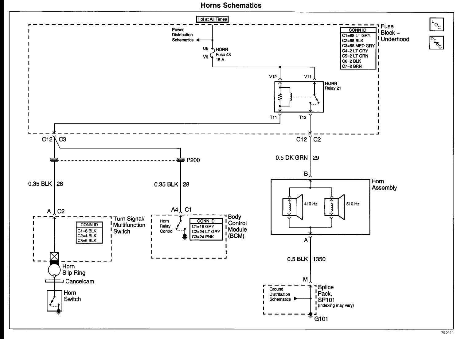

  • drumrickdrumrick Member Posts: 1
    im having the same exact problem as you did along with the trunk popping open by itself. did you find a remedy? i also have a 2001 alero. my mechanic cant figure it out either after 2 weeks. HELP !!! Thanx

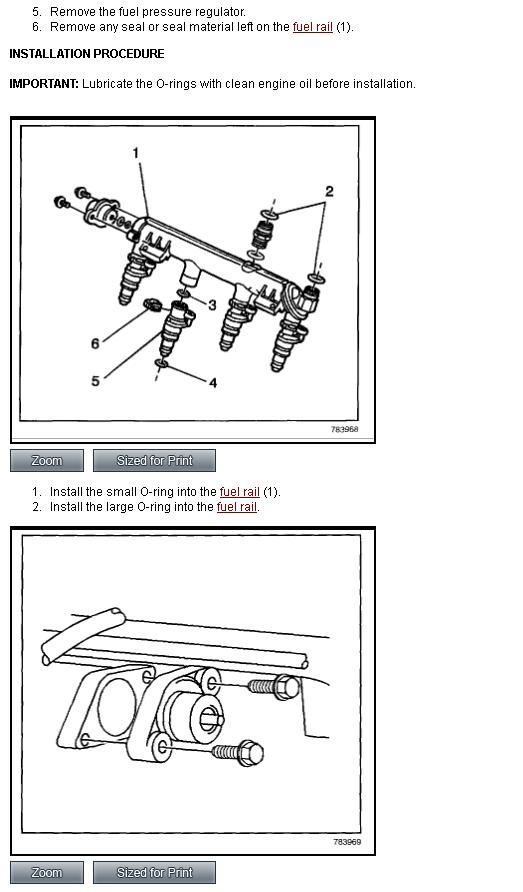

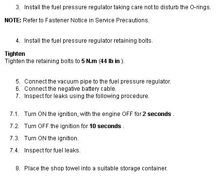

  • appellofappellof Member Posts: 54
    Greg,
    Do you know where the regulator is located? If not it is located on the top left side of the engine. It is round and has a vacuum hose connected to the top of it. The best way to test it is to remove the vacuum hose off the top and move it to the side. Then, turn the ignition switch to the "on" position.
    *******VERY IMPORTANT DO NOT TRY TO START THE ENGINE************
    Just turn the switch to the on position. Look through the opening between the hood and the dash. From the driver's seat you will be able to see the regulator. If there is a stream of gas coming out from where you pulled the vacuum hose from the top of the regulator, The regulator is dead.
    The BCM could cause the engine to stop but not likely.
    Try that and let me know,
    Daniel

    TBS10,
    I am going to try this. I am going to see if I can paste a picture here.
    Well that does not work. I was hoping that it would allow a picture to be posted. The moderators will not allow personal phone numbers to be posted. otherwise, I would text you the picture. You may be able to google the fuel regulator location and there may be a picture of it there.
    I hope this helps
    Daniel

  • lovemygrandamlovemygrandam Member Posts: 330
    OK. I was just kidding around about giving it to your fiance. Anyway, after reading further posts and seeing you are trying to find images that show the fuel pressure regulator, I checked in my manual for 2002 Grand Am with 2.2L L4 engine, which should be same as yours. I scanned the pages regarding replacement of Fuel Pressure Regulator, and posted the pics on my website. Take a look and see if they are helpful. You can access them at:
    http://www.bergerweb.net/graphics/FuelPressureRegulatorReplace1.jpg
    http://www.bergerweb.net/graphics/FuelPressureRegulatorReplace2.jpg
    http://www.bergerweb.net/graphics/FuelPressureRegulatorReplace3.jpg
    Here is the "Description and Operation" section of the manual:
    The fuel pressure regulator is a diaphragm relief valve. The diaphragm has fuel pressure on one side and regulator spring pressure and intake manifold vacuum on the other side. The fuel pressure regulator maintains a constant pressure differential across the fuel injectors at all times. The pressure regulator compensates for engine load by increasing fuel pressure as the engine vacuum drops.
    You might check for vacuum leaks too, since by the description, the fuel pressure is controlled by manifold vacuum.
