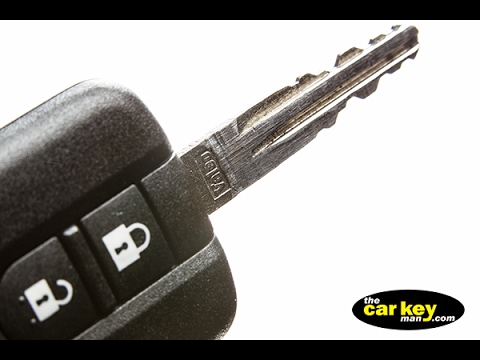

    Hidden inside the key fob should be a regular key. There is a lock cylinder in one of the outside door handles, (usually drivers side) that the key will operate.
    I checked for that, but could not find any keyhole anywhere on the car
  • thecardoc3thecardoc3 Member Posts: 5,860
    It should be something like this.
    https://www.youtube.com/watch?v=d32ZWHrJDPc
  • Dan_AnderssonDan_Andersson Member Posts: 3
    Found it! A tiny little key symbol on what I thought was just a piece of plastic. Would never have found it without your help. You are a genius! Thank you sooo much! When I called the Nissan shop last week, they said I had to have it towed to the garage...... :) You're a legend!

    So, it was a plastic cover over the keyhole on the door handle?
    Yeah. The idea is it keeps crud out of the lock cylinder since it almost never gets used. Otherwise by the time someone needs it, it would be seized.
