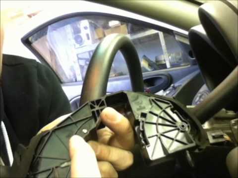

    I saw this video and it would seem you should be a be able to pop the top cover off and while the unit is intact use your touch to see if the clicking is coming from that unit they go on to remove and clean contacts inside.
    https://www.youtube.com/watch?v=e5g-1UkGFJA&feature=youtu.be
    The link to the video was on this search site and I see one of the comments says to be sure to read the comments below the video about things to keep in mind while doing it that aren't fully covered in the video.
    Also I notice on the page that linked to the video one person said to replace both the turn signal and hazard switch with parts from online source on ebay. Myself I like rockauto.com to determine part numbers and so on. But price comparing may be good.
    Might be easier to replace if cleaning the contact doesn't help.
