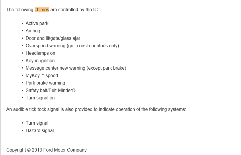

  • thecardoc3thecardoc3 Member Posts: 5,863
    Sorry, cant help with this one. I even tried using my scan tool to command the different chimes on my 2010 Escape and the only difference was the speed of the three tone chime. Mine does not do that two tone at any time. Looking in the owners manual there is a chime mentioned, "if equipped" that only alerts when a new message shows up in the drivers information center but even that specifically says except for the parking brake applied warning.
    The only thing I found in Fords service information are these two captures.
    If I had the car I could command the different chimes to see what it is.
