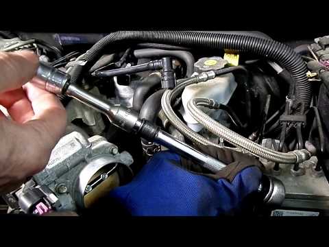

    Does the sound remind you of a small vacuum cleaner? If so then it might be normal. During start-up the secondary air pump runs to lean out the air/fuel ratio in the exhaust and also assist in getting the upstream catalytic convertor to light off.
    edited May 2019
    Here's a video for a 2009 where he shows the location of the air pump on that year. I post the video only that it might help you locate the pump for when you listen for the source of the sound.
