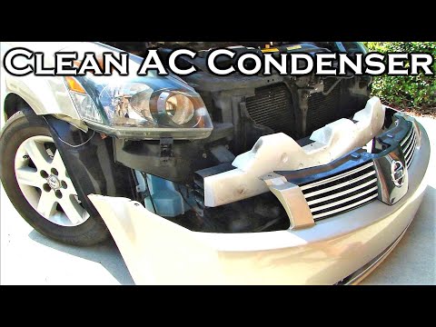

    Since you say it functions when you're on the highway, It might be all you have going on is a blocked/clogged condenser.The highway speed moves enough air to keep things from overheating and shutting down the AC. When you're going slower around town, there's not enough air moving through.
    Here's a video about cleaning an AC condenser. Not on a Lexus, but it should give you some idea of what's involved and shows how gunked up they can get with bugs and various road junk
    https://www.youtube.com/watch?v=-INC2Y2Hrhs
