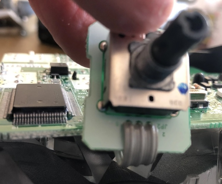

  • jtumisjtumis Member Posts: 3
    Fuse is not the issue. The wire connecting the temp control knob to circuit board is too short and has separated. Give me a few minutes and I will find you step by step instructions to fix yourself. I did it and had never done anything like this before. Car shop will charge you a $1000
    Here is the problem and the fix. Whoever put this on the Internet gas saved a lot of people money.

  • JabberwoJabberwo Member Posts: 4
    Hi.
    Old thread I know, but similar problem. 2006 Highlander suddenly has no heat. A little different because in my case the A/C button lights up all the time; pushing it gives tactile feedback but light remains on. Recirc air lights up unless direction is turned to windshield. I don't think there is any warming of the air, its frigid and doesn't clear the fog off the inside of the windows. Water temp nominal.
    I read through this entire thread, all my knobs are firm and verified no loose nuts underneath. Thanks to some excellent youtube videos I got access to my environmental controller. All my ribbon cables look OK, no broken wires or solder joints.
    Please, any other ideas? It's cold out there! ;-)
