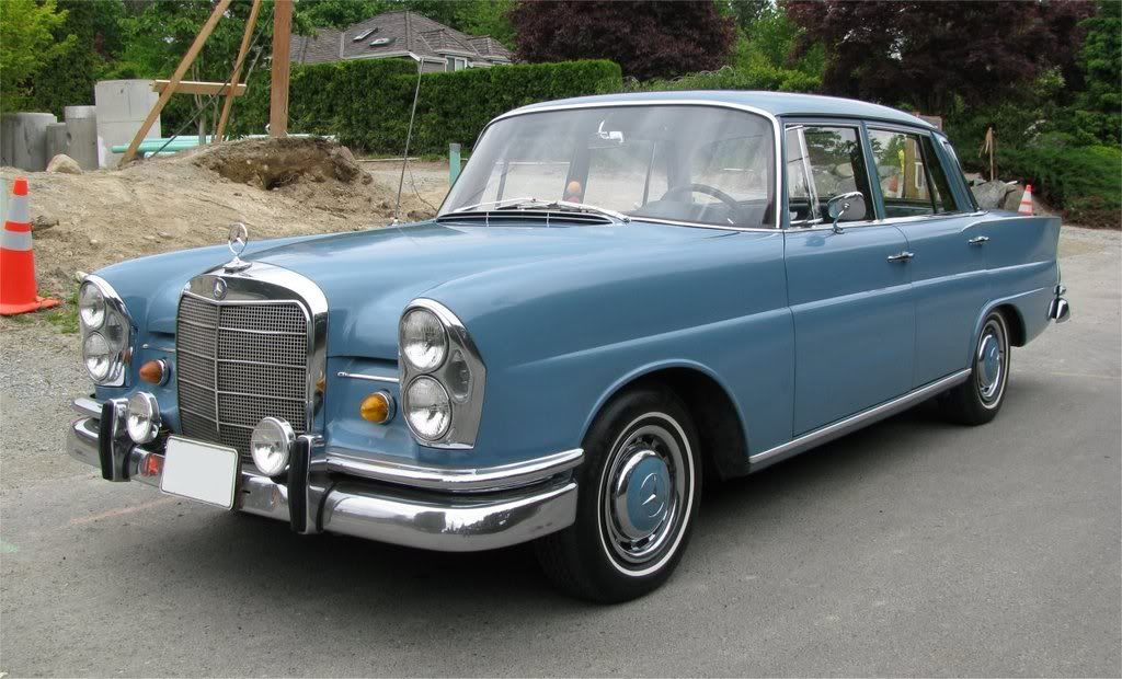

  • fintailfintail Member Posts: 58,874
    I have an ancient Mercedes which predates clearcoat paint. The car doesn't seem to shine like it used to, even after I wax it. The paint seems somewhat hazy (it is a medium blue) and it looks shiny from some angles, but in direct sunlight when one looks from overhead, or under a light in a parking garage, it is not. When I last waxed it a couple years ago, I stripped off the old wax with dish soap, used a gentle polish, and put on a couple coats of wax. It didn't seem to help. Should I use a rubbing compound on this? Someone also suggested to me a fine wet sandpaper, but I don't trust this. Or is the paint just old and that's how it is? The car is garaged and is only driven a few days per month. I have owned the car for many years, and it seems the car was shinier in the past.
    I don't know. But the paint itself is smooth as a baby's bottom - I have always kept it waxed and I know the car was garaged by the previous owner along with myself, so that goes back over 20 years. The paint just doesn't seem to shine as I want to remember it did when I bought the car, rubbed out the paint, and waxed it. I know it's been well over 10 years since I rubbed it out last. Maybe since my normal cars have clearcoat and they have shined like new, my expectations have been warped a little.
    I tried a little spot of rubbing compound on the car when I had it out yesterday....I couldn't really tell a difference once I put some wax back over it. I wonder if compound plus polish plus wax would do it. Or maybe I should bite the bullet and take it to a good detail shop.
    Well, the old car is now at a higher end detail shop. I tried to rub it out, polish it, and then wax it - my test panel (trunklid) showed virtually no change. The paint needs a machine polishing, something I can't give it.
    The guy at the detail shop, who I believe was the owner, was impressed with how smooth and strong the paint on the car felt and looked. He wasn't worried about it not coming back to life, it seemed pretty routine to him. I won't have time to pick it up until late Friday or Saturday...should be fun. A little expense, but since the car got nothing but an oil change last year, I guess I can handle it.
    This is also the first time I have ever taken one of my cars to a professional detailer - I have always done it myself in the past.

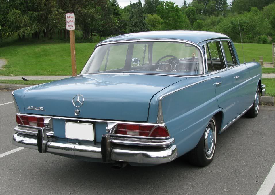

    Well, I got it back the other day. The day after I took it in the guy who runs the place called me to say it wasn't coming along as well as he had hoped...apparently he and his crew just couldn't get the old paint to shine up like new paint. He expected better too, but I guess it doesn't look too bad...the only thing is that I can make it look just as good myself. The positive side is that he didn't charge me for much more than a wash, even though they did wax it. But he said he used several different polishes, including a very aggressive one, and it had nearly no effect. He was saying how the paint predating clearcoat was a factor, but I don't know. Anyway, here's how it looks now, not much different from before.
    One view
    Another angle
    (pics are from yet another cloudy day, not much sun this year)
    It has kind of a muted shine, but not the mirror gloss I had hoped for.

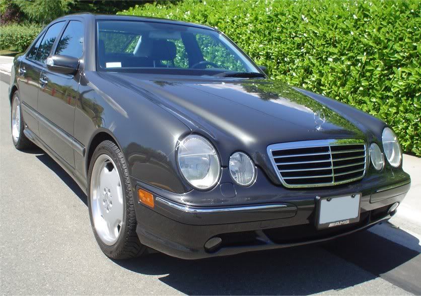

    Clearcoat paint can really make a car look good.
    I use Meguiars NXT to maintain my modern car, and it looks like new
    I think my expectations might have been too high. Oh well, now I don't have to worry that I was doing it wrong, and it didn't cost me a whole lot. It's an old car that I want to keep in an "unrestored" state as long as I can.
    Maybe we'll see sun in August.
