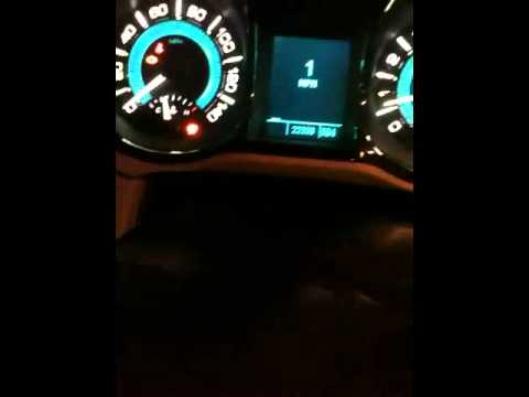

  • buick55buick55 Member Posts: 1
    I am having a similar problem with my 2010 LaCrosse , but with mine the car after being on for a lil while goes into a parking brake mode. The engine light turns on, the parking brake light turns on and the car slows to 1 mph. Sometimes before this happens the doorlocks go nuts rapidly going up and down.
    I video'd the park brake problem on my iphone and posted it to show the dealer whom has tried to fix it 3 times.. My next move is lemon law because it is a potential danger to drive with my family on the highway.
    heres the link..http://youtu.be/tVtKRS2v2Sg

  • lefttoyotalefttoyota Member Posts: 2
    Each time my car shut off, the car displayed similar actions as shown in your video. Tthe engine light came on, the park assist would turn off and then the car shut off. The best experience of all was calling the Buick customer care to get the car towed. I was told they would tow the car to the nearest dealer which was not near my home and I would "have to get myself home". I called the dealer for assistance only to get nowhere. So I am sitting in a parking lot after rolling the car off a busy freeway. No one seemed to care that a brand new car had just stopped while I was traveling over 60 miles per hour on the freeway. And then to be told to find myself a ride home was a bit more than I could stand. It amazes me how excited they are to sell you a car but show no ownership when the car has a problem. I guess I should be grateful I did not lose my life.
