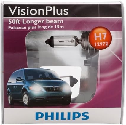

I have an 04 Sorento and have struggled with headlight replacement and dome light not going off. This worked for me. Instead of buying the expensive headlights at Wal-Mart or Autozone, I ended up buying Phillips brand from Kmart. Came in a 2 pack for like $20 ( I got a few boxes on clearance for $8 ea) and these have not burned out yet.
Please ensure this is the right size bulb for YOUR vehicle before purchasing, however, it was the right size for mine.
