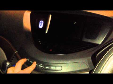

  • Now my 2008 Tribeca has the exact same issue, and it is outside of warranty. Can anyone tell me whether what the problem is, how to fix it? Thanks.
  • Here is the clip to better explain the issue.
