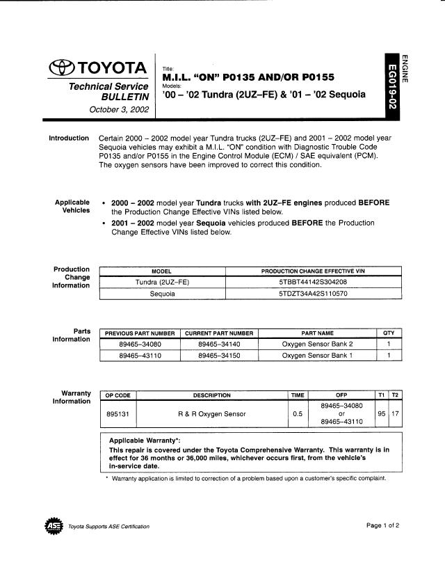

TSB EG019-02
Applies to the Sequoia with VIN # lower than 5TDZT34A42S110570
Basically, the oxygen sensors have been failing prematurely sending failure codes P0135 or P0155.
Previous Oxygen Sensor Bank 2 part # 89465-34080 has been replaced by # 89465-34140 and Oxygen Sensor Bank 1 part # 89465-43110 has been replaced with part # 89465-34150.
Replacement of these parts is covered within the 36/36,000 mile warranty.
It says that application of this warranty is limited to correction of a problem based upon a customer's specific complaint. Whatever that means. I'd imagine that you at least have to have the check engine light on with the above failure code, retrieved by their diagnostic equipment.
