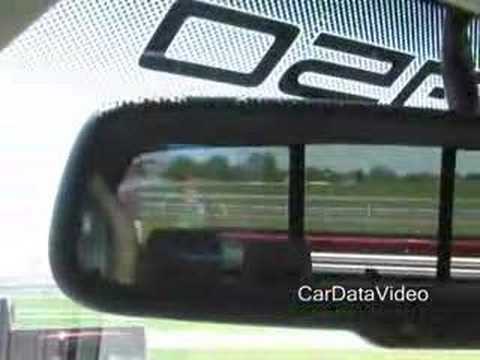

In addition, you can get the new cool backup-video-in-the-rear-view-mirror option that Ford is coming out with this year. Check it out here: http://www.youtube.com/watch?v=3duZVs7ARaU
