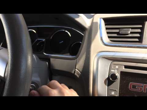

  • thecardoc3thecardoc3 Member Posts: 5,858
    To get the car to crank it still uses the same safety inputs that have always been needed such as the key command, and the park/neutral input from a transmission range selector switch. But exactly how the system uses those is very different from what was done in the past. The ignition switch doesn't carry any significant current, it's just a command to the BCM, and the mode switch which is inside of the transmission that generates the park/neutral information is just an input to the TCM. The BCM and TCM then send that information to the PCM. The BCM communicates on the high speed data bus, while the park/neutral signal is a dedicated line between the TCM and PCM. When all of the inputs are correct the PCM commands the starter relay to crank the engine.
    While the video displays the reported issue, it actually does nothing to help a technician logically rule anything in or out. Once the car starts beyond some potential historical codes it is unlikely that a solid assessment of the cause can be made.
