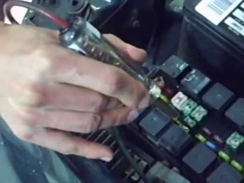

    Do you know how to use a voltmeter or a test light? Do you have either a voltmeter or test light? If not now would be a time to buy at least a test light. Here is a little video on how to use one.
    https://www.youtube.com/watch?v=ksrsXwwukFc
