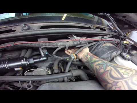

    Here's a video the MAY be helpful. I don't know if it's the same body and wiper type as you have. See if it gives you any help.
    https://www.youtube.com/watch?v=UrxPS0Ngb4I
