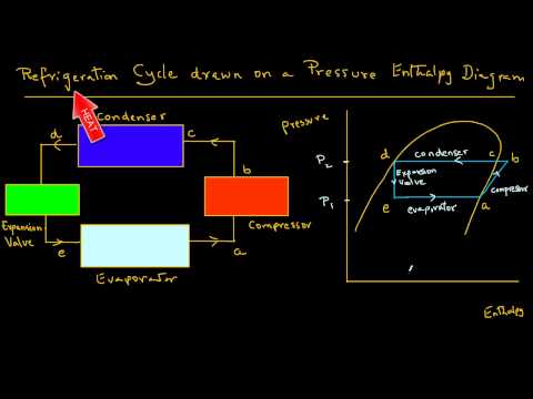

    ENTHALPY: a thermodynamic quantity equivalent to the total heat content of a system. It is equal to the internal energy of the system plus the product of pressure and volume.
    (Had to look that one up!) :p

    LOL, you aren't alone. I had to go through numerous definitions and examples to get competent at really teaching the concept. To arrive at the full correct charge we have to maximize the heat that the system can move, which BTW doesn't happen at the maximum charge. Heat is more than just the temperature. For example:
    Which has more heat in it, the warm refrigerant liquid entering the evaporator or the ice cold gas leaving it? The cold gas of course has much more heat in it. That's where explaining the latent (missing) heat of evaporation comes into play. You can see the heat that was picked up during vaporization when the gas is compressed by the temperature rise at the compressor. Then the enthalpy chart helps show how efficient the system is by how much the refrigerant can be cooled as it condenses back to a liquid. The shape of the numbered polygon in the center of the chart is defined by the efficiency of the heat transfer in both the evaporator and the condenser.
  • kyfdxkyfdx Moderator Posts: 271,018
    I'm still not exactly sure how A/C or a heat pump works. I sort of get it, but not really. Guess I was better at math than physics.
  • thecardoc3thecardoc3 Member Posts: 5,861
    When the gas is compressed the heat in it is concentrated so the temperature of the gas rises. Heat always moves to something colder, so the first goal is to get the temperature of the refrigerant to rise above the ambient temperature. In automotive systems you will usually see compressor outlet/condenser inlet temperatures around 130-160f. With the refrigerant temperature that high, the heat in the refrigerant can be transferred to the atmosphere. As the refrigerant loses heat it falls below it's boiling point (which is raised by it being under pressure) and condenses into a liquid. As it does this it releases a large amount of heat, known as the latent heat.
    The refrigerant then goes through the expansion device where we get a resulting drop in pressure. The pressure change changes the boiling point of the refrigerant and it absorbs a large quantity of heat as it evaporates. The heat that it absorbs comes from the air inside the passengers compartment.
    Watch this video which explains enthalpy quite nicely.
