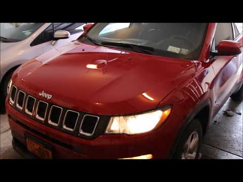

    Here's a guy on YouTube that seems to have had the same problem as you:
    https://www.youtube.com/watch?v=UNeOhULryus
