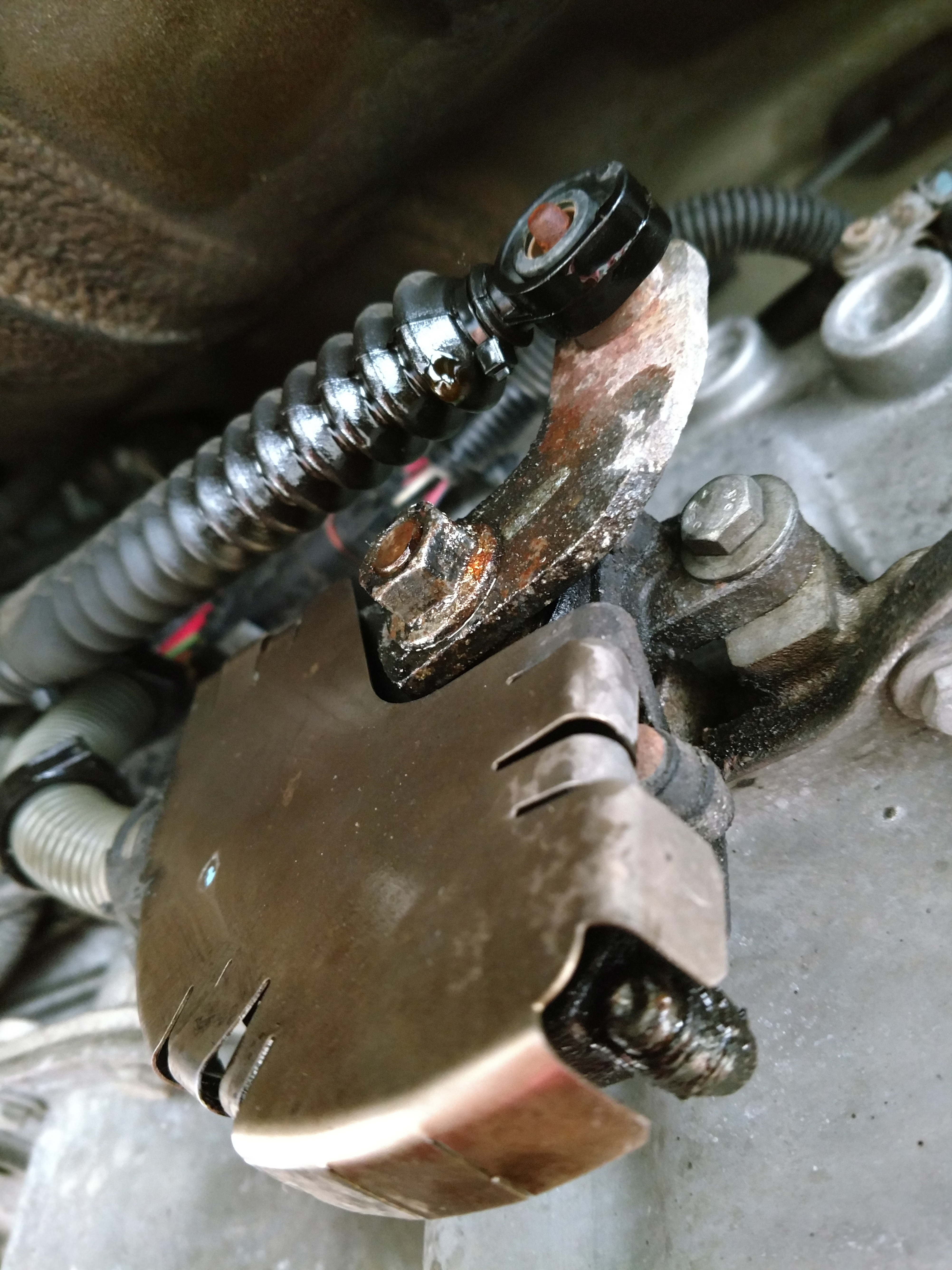

  • drag0micr0drag0micr0 Member Posts: 1
    For those who are looking for even a little guidance on replacing the 98 isuzu rodeo neutral safety switch, here's a picture of it. It is on the driver side as stated in another post. It's pretty much under where the stick shift is and was rather easy to replace and just required a little force to get everything unscrewed and popped off. It took me a little over an hour to do
